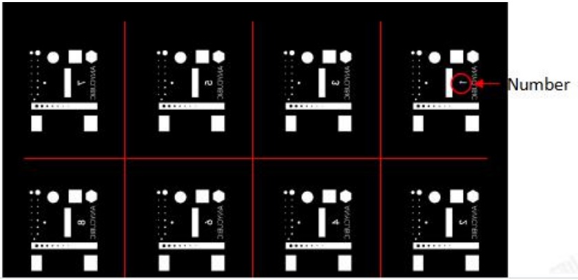

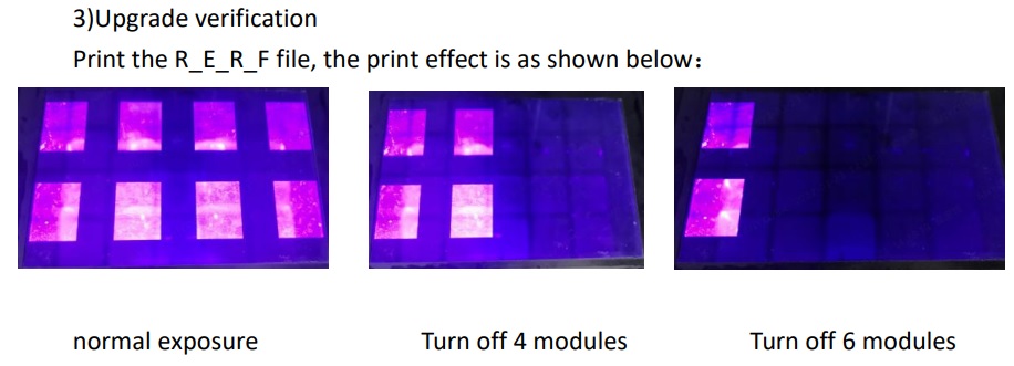

Ik kopieer de tekst vab de bovenstaande plaatjes maar even, die verklaart het precies.Ch3vr0n schreef: 15/12/22, 17:55 Ik snap niet echt hoe je dat RERF bestand moet printen/gebruiken om te kalibreren, laat staan om meerdere modellen op de plate een andere belichting te geven.
"R_E_R_F" is the abbreviation of "Resin Exposure Range Finder", R_E_R_F file can be used to test the best exposure parameters of resins from different manufacturers. Import the R_E_R_F file attached to the U disk into the slicing software. The R_E_R_F function will divide the screen into 8 equal parts in the order shown in the figure below. The exposure time of the model with model number "1" is equal to the "normal exposure time (s)" in the slice settings. ” (except the number of layers at the bottom), the other numbered models will be sequentially incremented with a gradient of 0.25 s. For example: When the "normal exposure time (s)" is 2 s, the model numbered 1 will be exposed for 2 s, the model numbered 2 will be exposed for 2.25 s, and so on.
The parameter "Normal Exposure Time (s)" can be modified, that is, the exposure time of the starting model (model numbered 1) is modified (it is also valid during normal printing), and the exposure time of other models will be 0.25 s in sequence. Gradient increments. Actually print the R_E_R_F model file, remove and clean the model, and then observe the model. The exposure parameter of the model with the best printing effect (complete model
printing, clear detail printing, and best hole accuracy) is the best exposure parameter of the manufacturer's resin. . Note: "R_E_R_F" is the key file name, the machine will recognize it separately, please do not modify it, and please do not name the normally printed model "R_E_R_F". 2.1.3.2 Update 2: Change the lifting height after the model is printed. In order to make it easier to remove the model and the cover, it is changed from the original lifting to the highest position to a lifting of 40mm.
Dus in plaats van dat je allemaal aparte prints met verschillende belichtingstijden moet maken, kun je die nu in één printgang 8 verschillende maken.
Ik heb inmiddels zo'n R_E_R_F testprint gemaakt en het werkt inderdaad prima. 8 modellen in 1 run met 8 verschillende belichtingstijden.
